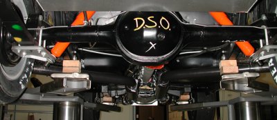

  5. Cassidy
    Cassidy Member
    10
    Aug 20, 2007
    This is a photo of the under side of my car.
    65 GT350R recreation --- 5R102
