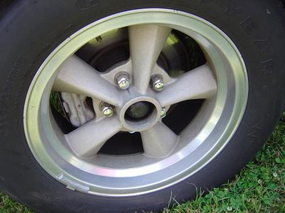

    I saw these on a shelby, can't remember if 65 or 66
    sorry
  11. shlby66
    shlby66 Well-Known Member
    84
    405
    Jan 22, 2006
    East Coast - NJ
    67GT350, Nice picture of a vintage aftermarket aluminum wheel. I would
    guess ( 1st guess ) this is one made by ANSEN in the late 60's. Notice the
    slight ridge that runs the length of the spokes. Also, see how the rim has
    a 90 degree edge before it goes down to the bead area. There are radiuses blending into the spokes from the center section. Really neat stuff. This set looks to be in really nice condition. Lucky owner!
