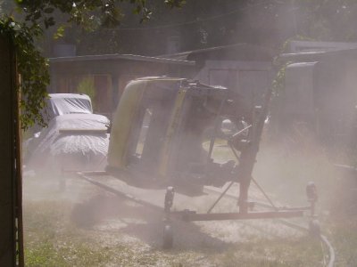

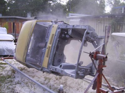

    REMOVE the Tag!!!! And do it before that car gets out of your sight. My car went to the sandblaster and let me tell ya, those guys could care less what they blast. I "taped" an area off that I didnt want blasted, well it got blasted anyway. When they blast they can hardly see with all the dust being made so your tag will get destroyed. When I dropped my car off it was immediatly surrounded by car guys and the first place they went to look on the car was the spot where the Shelby tag was to see if it was real. Now just think if the tag was there and the shop had an employee that was bad news and decided after hours to steal the tag? It would be to bad to sad for me.
    So hopefully this helps you decide to REMOVE THE TAG.
    Heres a pic of my car being blasted by a southern boy who could car less where his blaster gun goes...look at the dust cloud...
    Jim
