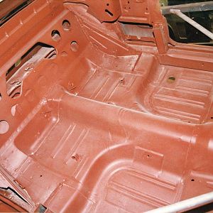

    i think this Shelby use to go offroading..hahaha, the front floor frame supports are totally smashed in..I mean really bad to a point of them being replaced. So yes the rear traction bars are badly bent, because of that they have been removed :( . This Shelby has been sitting since 1980. I was told they were dealer installed. Who knows...not that it matters since they have been removed. If the same traction bars are still available I will be reinstalling a new set. I left the front welded plated on the car just for that reason. ;)

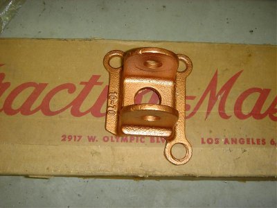

  3. Bob Gaines

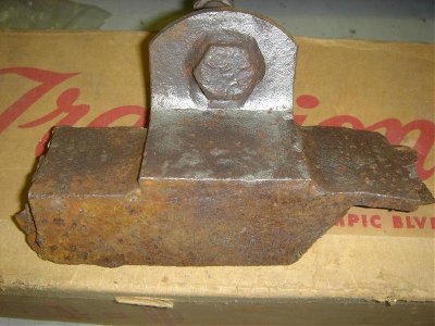

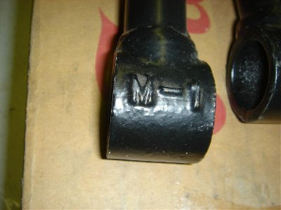

    The first picture you see the assembly line Traction Master lower plate.It has the distinct shape and what looks like 3 legs. The color is copper.The angle iron is the extra reinforement used on 66 Shelby's .If it doesn't have the reinforcement a red flag should go up. Shelby stop using traction bars at the end of the 66 model year. The 67-70 style looks similiar to the picture but the 66 uses narrower U bolts.So the 67-70 unit has a wider spacing on the brkt. The assemblyline traction bars have a M-1 cast in the end.

    My front bracket looks like the one pictured. The rear bracket on mine has evidently been beefed up. I will have to check for the M-1 on the bar. I did check my backing plates, and the adjuster plug holes are still closed off. I see you are in Kansas City Bob. I am in Warrensburg. Cheers..

  7. Bob Gaines
    Bo, the 67 style TM bottom plate will look exactly like my posted picture of the 66 plate with the exception that the bolt pattern is wider for the 67 style U bolts.

    I will take some pictures of mine. Posting them will be another issue. I checked my bars today, and they do have the M-1 on them. Are the traction bars supposed to be straight? Mine have a slight angle to them.
