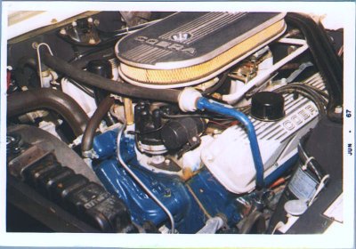

    Jimmy, It should be blue. A paint mask was used to shield the intake but the theromstat housing got painted . I posted a owner taken photo from 1967 .Bob

    Bob Thanks, I actually have that photo too. Got it from the NVSAAC site where about half of the restored engine photos show it non painted!
  3. Bob Gaines
    They also mostly have the incorrect thermostat housing for a 67. Bob
