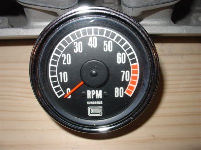

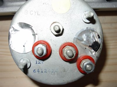

    Finally, a question for you:
    The last repair done on my 65 tach performed by a reputable shop meant
    the +12V connection became obsolete and he removed the red plastic
    insulator and cut the post. It is now just driven from the coil.
    Does that mean the movement was replaced?
    Tach works like a charm. Pictures show a NOS tach.
    /Texas Swede
