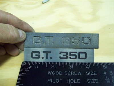

  9. 6S1431
    6S1431 Well-Known Member
    Mar 3, 2008
    Here is a picture of the orginal rear emblem on 6S1431 and a Scott Drake Repo. Also a picture pf the orginal cleaned up. Found no evidence of any kind of paint on it, one of the original retainer clips is also on the stud.
  10. jbarela
    jbarela Well-Known Member
    142
    Apr 10, 2008
    nice pics..what is the exact length and width of your original emblem...thanks
    JImmy
  11. 6S1431
    Mar 3, 2008
    The original emblem is 4 1/2 inches long, it is about a 1/32 of an inch wider then the Scott Drake repo, I did not measure the actual width, just compared the two next to each other. I also inclosed a shot of the car in 1973 at the Bonneville Speed Trails, several cross country trips in the early 70'2 and stops at Bonneville helped create the rust problem

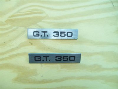

  12. YELLOWBOSS2
    YELLOWBOSS2 Well-Known Member
    Mar 30, 2005
    S.E. Florida
    Here is a picture of the original emblem off of mine and it clearly shows a coating of some kind
  13. Snakepit
    Of course, currently, there is no way to determine if the "coating" is original or something someone else did.
    Thanks for the picture.
    Wonder how many of these are early reproductions (even placed in Ford boxes) and or how many different versions Shelby used from different batches?
