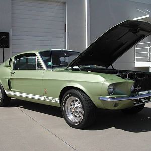

    I would like to change my original coil springs out with a pair of Easton springs. I have removed the export brace and shocks. What else do I need to remove in order to drop the suspension on one side at a time so that I can romove those springs? Just want to make sure I am removing the correct components before I tackle this
    Any tips and tricks you might suggest. This is the only part of the car that I have not worked on for the past 10 years and honestly need some suggestions by those who have actually completed this on their own car.
