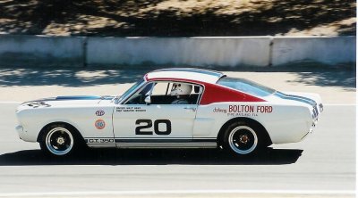

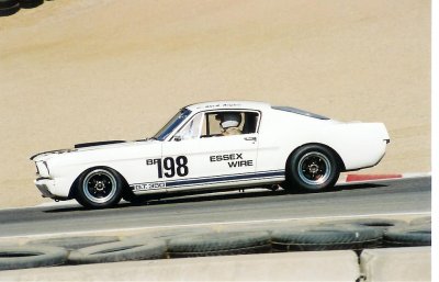

I'll dig through my pictures at home (I have a lot of shots of R-models) and see if I can provide any dash pictures to help. Of the one's I have digitally on this computer, I thought these two were interesting as they really show the modifications made to the front of the front fender wheel openings on 5R098. I've seen the car in person a couple of times and they never stood out to me, until I looked at the side shot I took at Laguna Seca 2003. The other R-model is 5R103 for comparison.

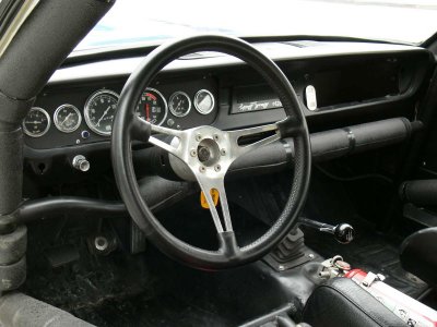

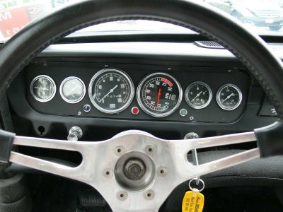

Actually I said, "partially in front and partially behind the opening". Which means in front of the tabs but tucked behind on the sides as in the photo attached. Although when I tried to tuck the right side behind the dash, near the radio opening, it bends the gauge panel way to much, so i trimmed it flush with the opening. And yes I have seen cars with it just screwed on from the outside with little or no trimming. The photos attached are 5R 530 and shots i have of 5R001 are the same. Cheers.
Hello racingdivision, Your posted pictures of the dash is the correct look. From the sounds of your description your lower right front screw tab may be pulled or bent too far forward requiring your gauge panel to arch. My suggestion is to bend that lower right front tab accordingly, carefully of course. The thickness of the metal is pretty tough, not to worry about breaking it off. Also check if there is too much excess material on the right curved side of the opening. That would have the same effect of the tab being too far forward. Note* There will be a gap on both left and right sides of the opening from about the top the fuel pressure gauge and the oil temp gauge as the contour of the dash board curves forward. Your described issue is very correctable. Good luck. ~Earl
