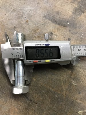

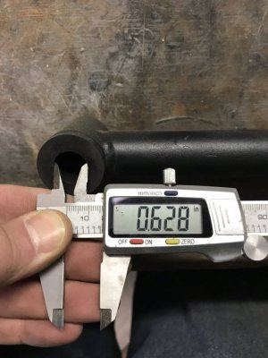

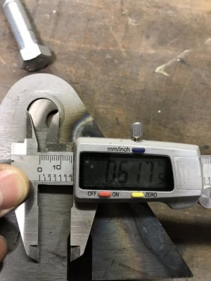

    Now, working on my GT350R clone, I’m in front of the override traction bars again ....and asking myself ...if these dimensions can be work, or the bolt should have a bigger diameter? See also the images..
    Bolt (0,556 inch)
    bracket whole (0,617 inch)
    bushing (0,628 inch )
    Who has been running into this subject and fixed it in what a way? Or maybe I’m hunting a death horse?
    Are my bolts so much at the lower end tolerance?
    Anyhow, I talkeed to VirginiaMustangs, who selling bolts as original (5/8 inch) ...which is 0,625..which would be pretty tied!

    When I installed mine the bolts went in tight, had to lightly hammer them in, the tighter the better here, and lube.
