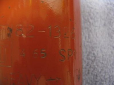

    Hi,
    Like to tell you guys an incredible story about my KONI Shocks.
    Got two front ones dated 4-65 in a trade and found out that the number
    didn't match my current ones, 82-1326 instead of 82-1388.
    An email to KONI in Holland solved that issue. Shelby 65 used 82-1326
    in the front and 82-1327 in the rear and in 66 they changed to 82-1388
    and 82-1389 respectively (if ordered, option you know). Never too old to learn something new.
    Now the only problem was to find correct rear ones.
    I remembered a box with several pairs of older KONIS that's been in my
    garage for about 18 years. Found the box and there were two dirty
    82-1327 rear ones dated 4-65. Don't remember where I got them
    but they may have been on my car when I bought it in 1988. Simply don't
    remember. Had a paint shop mixing the darker red color and a friend
    painting them for me. Yesterday I put on the KONI wing decals and managed
    to destroy two of them but I am very happy with the final results.

    Texan,
    Are both your rear Konis 82-1327 and what month in 65
    are they stamped with? Seems odd that the studs are different
    if everything else matches. If you are going to paint yours
    I can probably get the paint mixture formula from the paint shop.

  7. texan
    texan Member
    18
    Mar 7, 2006
    Yes both my rear shocks are 82-1327's. One is dated 4-65 and the other is dated 3-65. Both of the fronts are dated 4-65. The one with the coarse threads look like the stud had broken off at the step and had a coarse thread section welded on. I had noticed this when I pulled the shocks off 20 years ago.

    If your front shocks need fixing, don't send them to
    Koni America. A friend of mine with a 65 did that and
    when he got them back they had cut off the upper
    bushing loop and welded on the current type instead.
    The old ones, bushing loop, bushing and bolt pin are very different
    and Koni probably don't have that type of specific bushing anymore.
    Hopefully, your's, like mine, only need a good cleaning, painting and
    new wing decals. Again, if you need the paint mix write me a personal
    email and I will try to get a print out from English Paint in Richardson.
    These shocks 1326,1327 are specific to the 65 Shelbys and, in my opinion,
    as important as the tach, oil pressure gauge and so on.

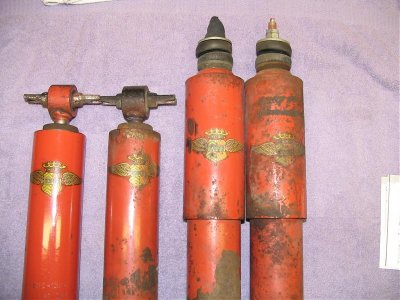

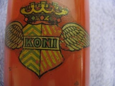

    Original shock decal photos. They obvoiusly didn't care about exact decal location back in 1965.

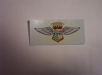

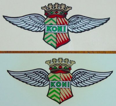

    Thanks everyone for the great pics! Here's a shot of the decals I have. The top one came with my 66 GT350 when I bought it in 1987. The Konis were put on the car in the early 70's by a PO who raced it, they have 69 date codes. Don't know the history of the decals but am assuming they were extras with those shocks? The bottom decal I bought from Koni within the last year. The differences are pretty apparent.

    Thanks for all the great pictures.
    The pictures of the original 65 decals that Texan posted
    are, in my humble opinion, quite close to the current
    decals that Koni sells. I certainly feel good about using them.
    They cost $1.25 each in comparison with the $3.95
    Mustang vendors charge and are probably better.
    Ordered another 20 last week and got them within 3 days.
    /Texas Swede
