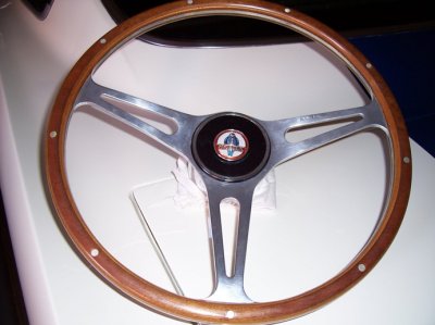

    hi - attached is a pict of a moto lito wheel which i have recently taken out of my car to replace with the original wheel. It has the moto lito inscription on the front right hand side....do you think this may be an original? cheers.
  7. shlby66
    shlby66 Well-Known Member
    83
    405
    Jan 22, 2006
    East Coast - NJ
    66SHLBYNZ, Yes, that is a MOTO-LITA 15" steering wheel, probably from the early 90's. I have seen the MOTO-LITA script on the front before, but not
    often. By the way, the 16" steering wheels have a split center ( the spokes
    are not attached to each other ) thus requires a retaining ring to attach it
    to the hub, while the 15" wheel is a one piece stamping. 15' & 16" wheels really dress up the interior of a Shelby.
