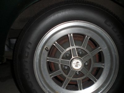

    OK. Here is a pic of the wheel from #3000. What can you tell me by looking at this wheel?
    Jim
  8. Coralsnake
    Those are definetly tapered spokes. That makes it an "older version" of the wheel. I think the period correct wheels have the valve stems between the spokes, but maybe someone can correct me if I am wrong. :thumbsup:

    That is one of the 80's reissues. It can be identified by the countersunk valve stem and the shank style washered lug nuts.
    Pete I could never correct you, but you are misinformed:thumbsup: What we would call vintage (67-68 versions) had valve on outer flange like the one pictured but they aren't countersunk.

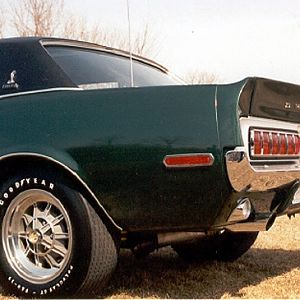

    I was told that that this is a correct wheel for 67. Tapered spokes and no countersink on the valve stem.

    Can someone confirm what version wheel I have. My wheels are just like the photo of "Ujak's" wheel except I can't tell if his wheels use a washer or a tapered lug nut. My wheels use a tapered lug nut. However, my wheels do not have any markings, numbers, or stampings of any kind on the inside of the wheel. SAAC documentation states my car came with 15" 10 spoke wheels, does anybody know approximately how many cars came with 10 spoke wheels?
  17. ujak
    ujak Member
    19
    Jun 25, 2007
    1GT500- the wheels on my 67 and in the picture do have a tapered lug nut. These wheels were on the car when I bought it in 1979 and I have no idea if they are original to the car.
