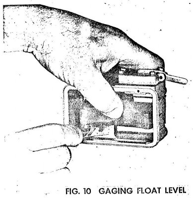

    I believe 1/2" for front float and 3/8" for rear float is the specification for GT350s. I made a permanent gage with one end 0.500 and and 0.375 on the other.
    Note: Using these float levels on an original Cobra (leaf spring cars) will create several problems as engines in Cobras sit in the chassis at a different angle than in a Mustang chassis.

    Dan is correct with the measurements on the float levels.
    Please remember though, that they are from the float to the
    top of the bowl. Many people makes the mistake to measure
    them from the bottom and the levels will be too low.
    See picture.
    Texas Swede
