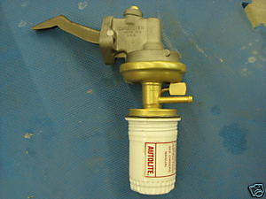

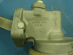

    Would you have the details/pic of the correct 67 GT500 unit? I have an after market one.

    67 GT500 assemblyline fuelpumps had CAR bura TER cast in the fuelpump. They had the distinct "button top ". I will have a auction for a rebuilt and replated assemblyline fuelpump on ebay in the next few days. My Ebay seller ID is gamera11. Bob

    Where are you getting the white filter bowls?
  8. Bob Gaines
    Re: Fuel Pump
    They come with the pumps I have found. You can get the repro 64 1/2 red ones but you have to paint them and silkscreen or use the decal. 67 got Autolite the 65 got FOMOCO. Bob

    Thanks for the pics. I've been watching your other Carter pump!
