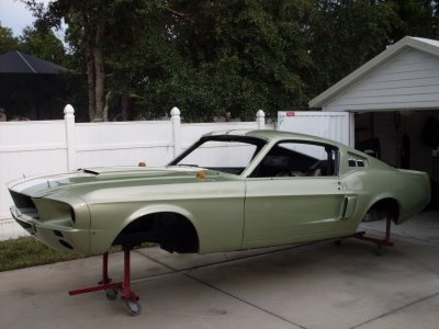

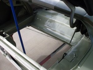

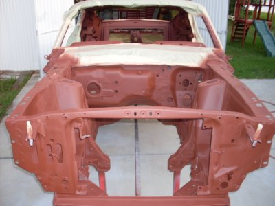

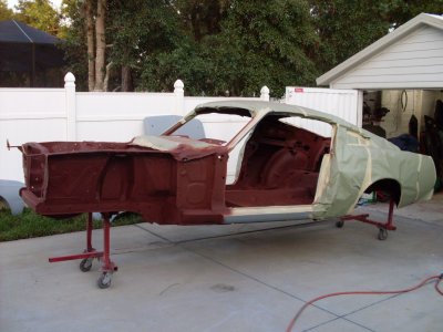

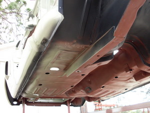

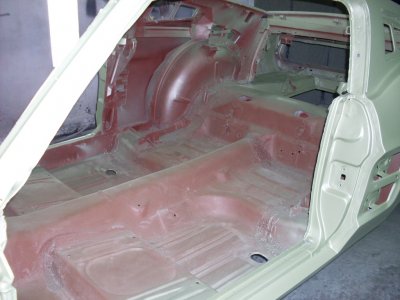

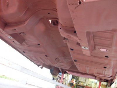

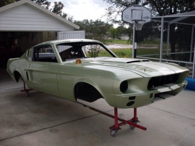

    Wet and dry block sanding is done. High and low spots are repaired. fenders, doors, quarters and roof are laser straight.
    First coat of red oxide is on. One more coat to go. I was uncertian which way I wanted to go when it came to the red oxide color and tone. I did a lot of research on here and got lots of advice from the "experts" on the proper red oxide color. Some say go bright red, orange or dark red. I went with the darker red. I was worried when it first started going on. It looked to dark in my opinion. I was very happy with the results. The color matches the ceiling of the car perfectly. The ceiling of the car is still in its original factory primer. It turned out to be a perfect match. Many argue what the proper color should be and Im sure i'll get grief about the color I went with. But like I said it matches PERFECTLY. The second coat will finish it of nicely.

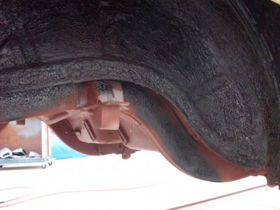

    Sound deadner and seam sealer is on.
    I'm days away from paint. Its time to set the appointment with my painter..WOW, I can't belive the day has come....

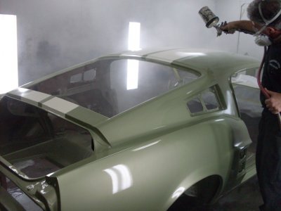

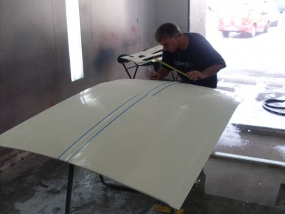

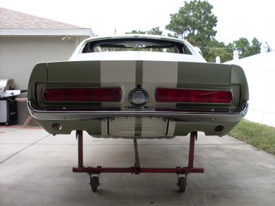

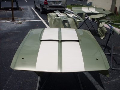

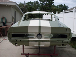

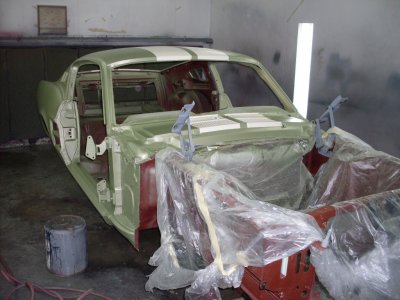

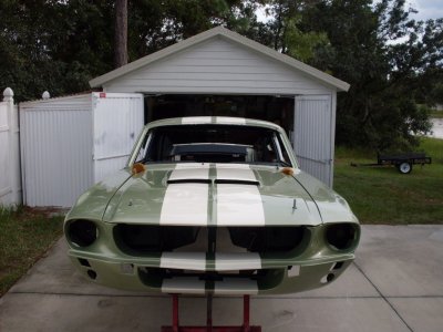

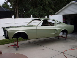

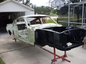

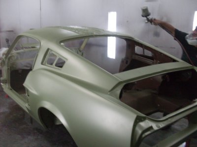

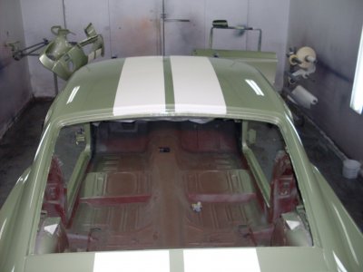

    While everyone was at SAAC 33 My friend and I were in the booth painting #3000. We started at 5pm on Friday the 15th and finished on Sunday at midnight!. We came home only to sleep and shower. The wives weren't to happy..lol. We had a total of 36 longgg invested hours in getting this paint job absolutely perfect. The stripes were a real pain in the ass but we got them down. I'm so happy with the paint job. Came out amazing. Got the car back home yesterday and stuffed it back in the garage. I'm to tired to even think about working on it. It's in pieces again so the engine compartment can be sprayed black. Then the real fun begins with assembly next.
    Its aliveeeeeeeee!
    Jim

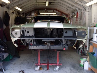

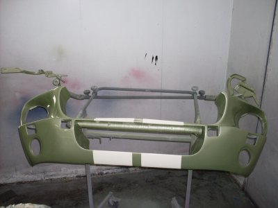

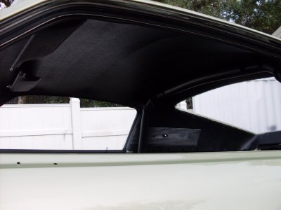

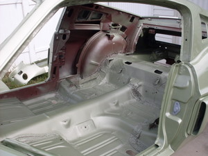

    electric, roll bar, headliner, brake lines, gas tank, fuel lines in...
    Also: does anyone have experience with the fender mounted headlight brackets? Did I install them correctly?
    Jim
  11. AJD350
    AJD350 Active Member
    Mar 13, 2007
    Near Chicago, IL
    Looks great! I love watching a project come together. The brackets look right. They are rather approximate in position. When mounting mine, I made the final adjustments using the play in the bucket screw holes and slightly tweaking the mount plates. A lot of fiddling, but the results are worth it. I can imagine the guys on the Shelby line just grabbing the bucket and wrestling it into place by bending it on the mount tabs. Al GT350 #3014

    i agree with the bend technique. Its going to be a lot of on and off trials to get them level and lined up..thanks!

    The headlight brackets look correct, from the photos...
    Car is looking nice...

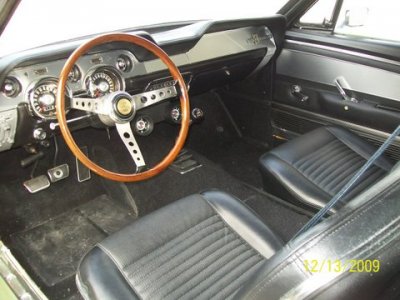

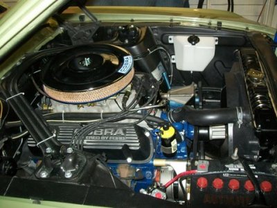

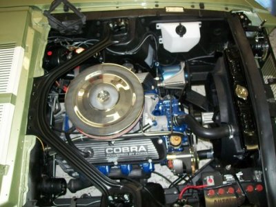

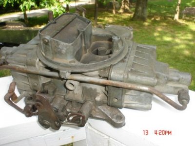

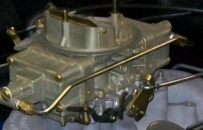

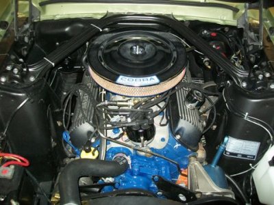

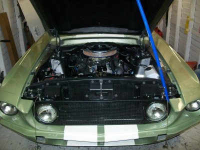

    motor done, carb restored, interior
