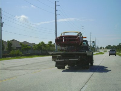

    Well after sitting now for 20 years Shelby #3000 is finally rolling down the road on 4 tires with the wind in her hair!..well, maybe 6 tires...oh who's counting?
    Thought ya'll might get a laugh from this pic I took following the tow truck taking my Shelby to the body shop for sand blasting.
    This Shelby is using the new HOVER technology...yes it floats!
    :p :laf:

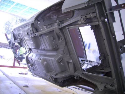

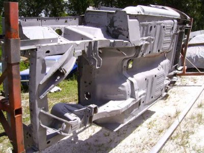

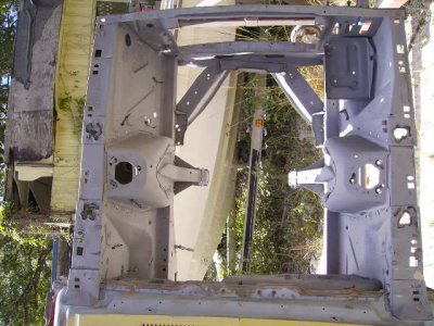

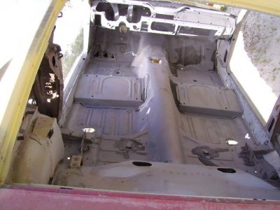

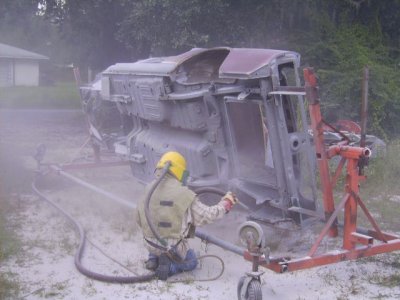

    I wanted to add some new pics. I was lucky enough to get these shots of the sandblaster doing his thing last week.:thumbsup: Great shots for the album. She has some rust on the drivers floor and toe board and the upper inner fender aprons, fixable for sure. Other then that, VERY solid indeed. Thank GOD the inner fender apron rust wasn't 6 inches more to the left or right, if so, bye bye Shelby stamp numbers!!..PHEW!!:wacko:
    Man o man I cant wait to get her home!:dance:

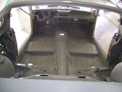

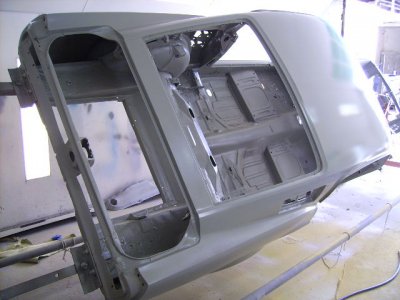

    few pics after roof chemical strip and complete epoxy primed.:)

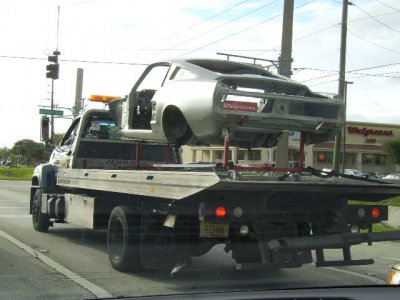

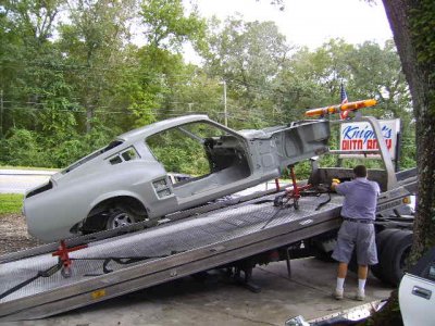

    On The Road Again
    NEW PICS FROM TODAY LOADING HER UP AND ON HER WAY TO A GREAT FRIEND WHO DOES AWESOME BODY WORK:thumbsup:
