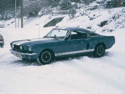

    This pic of 1757 was taken in January 1972 by the third owner and shows the original 10-spokes painted. I can't prove they were that way from Shelby American but none of the previous owners recalls painting them.
    The center cap background is also natural, I've seen original photos where the background is natural or black.

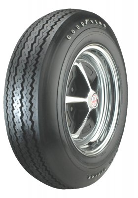

    PS, concerning the tires there is a nice original Blue Streak on ebay right now. It has the groove but can't tell if it was ever blue inside or not.

    Neat photo of your car in the snow. I guess with Global warming you won't have to drive it in snow anymore.

    72 and three owners!!!! Sounds like some of my cars. First road in 6S1203 (my wife's current car) in 72 and there were so many things little things changed at that point, but I remember us buying new cars during that ear and as soon as they got home off came exhaust, wheels, some even went to the painters the same day.
    As far as PO stories ........well we all know how far we can trust them. But thanks for the picture too bad we never thought about taking more at the time ;) Too busy racing and abusing them.
    Think the same seller (or one from the general area) had one with bead damage for sale a month or so ago. This one looks like the groove is there and its been painted black.... or the blue wore off.

    S1765 was restored by me for my best friend, between 1986 and 1989. He purchased the car from the original owner. The inserts on the 10 spokes were not painted black or gray. No evidence of any paint. When he sold the car in 1990, the Blue Streak spare went to another '66 owner. Joe.

    FWIW, just heard back from Kelsey about the new repop Blue Streaks. Here's what he had to say and a pic:
