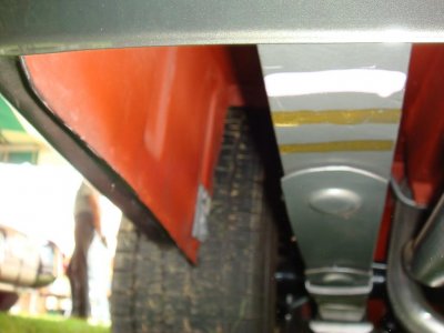

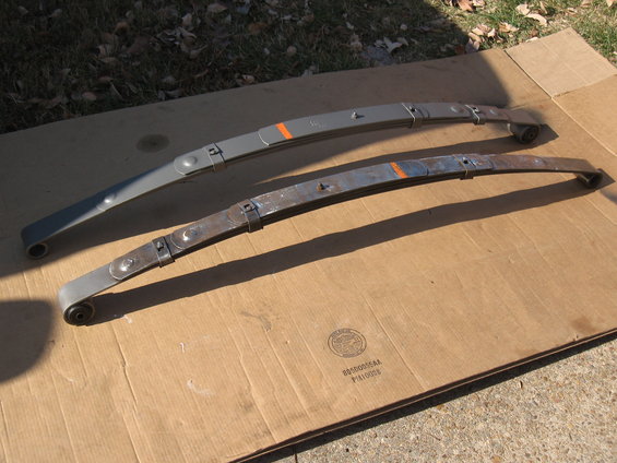

    Jerroll, my springs are painted with Eastwood spray gray, part number 1258z. As far as I know this is the paint everyone uses if your going to paint your springs.
    The picture below shows the original paint marks on my springs. I don't remake the paint marks if the original ones can be found. I taped over the original marks then painted the springs with spray gray.
    As you can see in the pictures a previous owner painted the springs and rearend floresent green.
    Kenny

    This raises another question?....How well accepted (in concours) are painted parts in lieu of the original finishes such as bare metal or phosphate & oil.

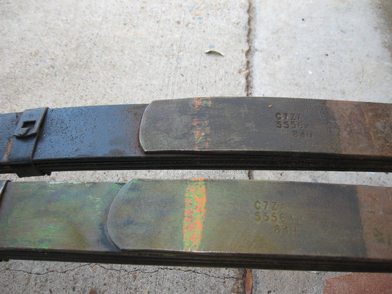

    Here are the only paint codes I have seen. the colors are right by my build sheet, but I'm not sure of the location.

    MCA concours and SAAC Div 2 can be painted as long as replicates original finish. MCA thoroughbred and SAAC DIV 1 must have original finishes. Even in the first 2 points can be deducted for "over restoration". A good example of this would be if you painted your leaf springs, U bolts and shock mount plates all with cast blast so there is no contrast between these 3 natural finishes.
  6. Coralsnake
    As TLEA said, you need to check the sanctioning body and class you are showing the car in, they vary in what they will allow.
    The color and location of the stripes will vary depending on the year and otpions/bodystyle of the car.
    1968s are normally striped with just one color code where Kenny did his. Kenny is nearly a genius.

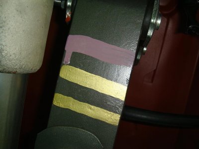

    Spring stripes for your particular car would be (from a 2/28/69 car - close as I could find)
    Front springs - 1 Gold & 1 Pink
    Rear springs - 1 Gold & 1 Violet
    Gold appears to have had a orange tint and no metallic. Violet is kind of a medium Purple
    Happy to help

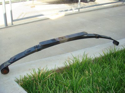

    69 and 70 Shelby's had unique leaf springs different in appearance from a 67 or 68. The length of the leafs are different from 67 or 68 Shelby and Mustang and in the case of the bottom plate it is straight and not curved. The S9MS engineering number on the bottom plate indicates it was a Shelby only unit. Some restorers unknowingly replace the bottom plate on a new set thinking it was the only difference. Knowledgeable 69/70 Judges can tell the difference. The only part of the leafs that is the same is the leaf that has the front in rear eyelet. From a maintenance stand point the procedure that Jeff Speegle oulined gives the most correct appearence and would be correct for SAAC DIV II, MCA trailered and Team Shelby Heritage class. Bob

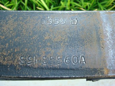

    Bob, you are a lifesaver. Getting to the shop this morning I pulled the rear springs off the cart and inspected them a very closely. To my suprise there was no Ford eng#(C9Z....) the bottom leaf is flat and there's a 9SM...# w/ another # above it and a small "keystone" symbol next to it.
    Imagine my disappointment....someone has put aftermarket springs on my car!!
    Now I find these are correct. Thanks to the knowlege in this forum I am saved from making a mistake it seems oters have made.
    Still my original question stands.....what is the correct finish for the rear springs on a 69/70 GT-500 for Div.1 or Throughbred? Is phosphate/oil acceptable?
    Also, I noticed these springs only have 2 clamps as opposed to 3 on the Ford springs. Any thoughts on this??
