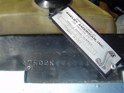

    This is interesting. A 67 GT 500 with a K code Ford vin.

    So what should it be and I'm asking a serious....
    question. I think that my '67 is a "Q' code. Is that correct?

    OK, if a Q code is the correct and only code for....
    a 428 Ford engine from the factory and you that to be an absolute fact then that fact screams that the 1967 Shelby G.T.500 on eBay is a fraud. Is that correct?

    Re: OK, if a Q code is the correct and only code for....
    I have been informed that there were some mistakes made and some were stamped with a K. This car seems to be legit.
    Frank
    PS--The 428 cars should have a Q as that is the engine code for a 428.

    I thought that this car "looked" legit but for the kind...
    of money that these cars bring now I just could not risk it unless SAAC confirmed it as the correct Ford number. Have you ever seen this before on a G.T.500? I have not.

    Dave Mathews (SAAC 67 Registrar) informed me that it is indeed legit for this particular car. Apparently there were a few mistakes made back in the day.

    Does the "star" at the end of the VIN number look different than it should be ?
  10. ShelbyLuva
    ShelbyLuva Well-Known Member
    Feb 16, 2007
    That was what I was thinking about the star. Also, the VIN is very messy, not straight.

    Some 67 350's also had a mistake with "A code" Ford Vins along in addition to these "K code" 500 mistakes. SAAC knows which cars were created this way... Those stars do look strange. I always thought all plants had real star shapes with a small circle in the middle... never seen stars that looked like big astericks. ...plus the numbers are crooked.
    I'm not trying to tear down this car but wonder if a Ford VIN could actually look that way for future reference...

    For reference - my chassis number. Note different star. I understood all 67s were built at the San Jose plant...?
    David
  15. Snakepit
    The Star in a Star is typical of San Jose during this period. There are a couple of other things that are "different" on original stars but can't really share.
