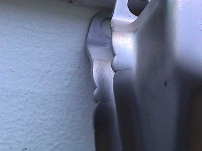

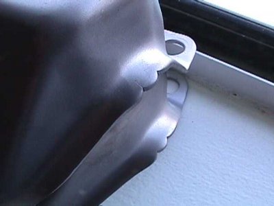

  5. jbarela
    jbarela Well-Known Member
    142
    Apr 10, 2008
    Hey here is an interesting thing also..this is a pic of our shock tower brackets...you can see on the edges its not smooth but rather has..well see the pics..I have not seen tower brackets like this before...
  6. s2ms
    s2ms Well-Known Member
    282
    Apr 13, 2007
    PNW
    My originals are the same as Jimmy's. I would also like to know if there were different OE styles. I've seen other cars with (supposedly) original brackets that have a straight edge and have bought several straight edge sets at swapmeets.

  11. jbarela
    142
    Apr 10, 2008
    does anyone else want to chime in on there shock tower caps versus the ones I posted a photo of?? we are 99 percent sure these are our originals...
    JImmy
  12. Snakepit
    Jimmy those are fine. Seen them less pronounced but the little waves are often there on other originals
  13. jbarela
    142
    Apr 10, 2008
    ahh...I am glad you said that..then for sure ours are original to our car and never came with the washers on them...I am going to have some put on anyways since they are supposed to have them...its great to see the minor variations on these cars..
  14. s2ms
    282
    Apr 13, 2007
    PNW
    Jeff, have you seen originals without the "waves"? If so, was it a production plant thing? Seems like I've seen lots of cars without them but really haven't paid attention if they were Shelbys or not.
    Thanks,
    Dave
  15. Snakepit
    Can't recall seeing any perfectly smooth but honestly not a little detail I've spent allot of time focusing on. Some of the waves are very light and could be seen as almost smooth.
    Have not seen any match (nor would I expect to) between waves or no waves and washers.
    Just one more thing to pay a little attention to ;)
