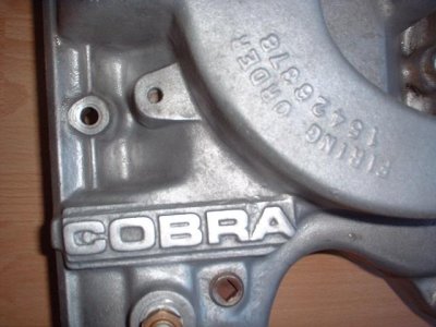

    There were also at least two different versions of the 66 manifold. One had the firing order cast on the rear flat pad while the other had it cast on the front #5 runner.

    Hey there 5S284, yes I believe you are right about there being more than two street variations, those are the only two I can think of, I think the other variations involve different sizes of the casting numbers? :confused:. Next time I talk with Cris I'll ask him about it, he probably has all the different versions in his garage. Great party, sorry I missed all the action when the Tiger guys showed up.

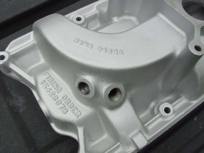

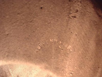

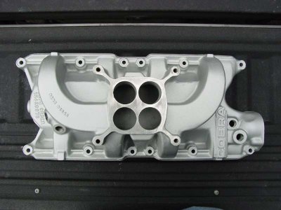

    Here's some pics of my original manifold from 6S1757:

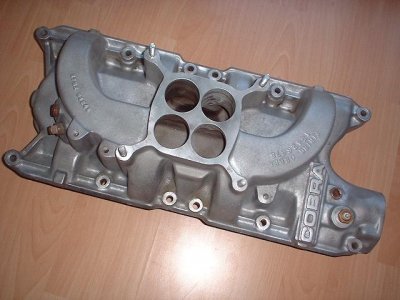

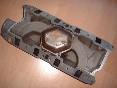

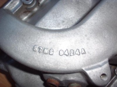

  8. Jerry_Moss
    Jerry_Moss Well-Known Member
    48
    264
    Jul 12, 2005
    Germany/Bavaria
    Here are some pictures please tell me your opinions.
    Thanks Jerry
