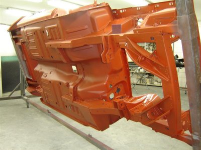

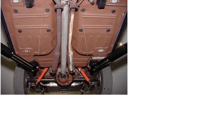

    My Shelby will soon be back home after sandblasting. The question I have is:
    What shade of Red Oxide primer does the undercarriage get?
    I see two shades of Red Oxide done on Shelbys. One color looks kind of orange in color and the other looks deep red. Anyone know which shade is CORRECT and where to puchase the proper shade by the gallon?
    HOPEFULLY THE PICS HELP A BIT.
    Thanks,
    JIM

    Mark, thanks a ton on that PPG number. I think with all the pictures i looked at of undercarriage cars, the brighter orangish- redish color like the car on the right will probably be my pick. The odd thing is the original red oxide primer on my shelby is all over the floors on the inside and outside but it looks alot like the color on the underside of the car on the left:blink: I wasnt sure if the color has faded and changed after sitting for 27 years.
    Im going to surf the web for that PPG number and see if anyone shows a color sample.
    Thanks again!
    JIM

    Greg:
    WOW!!..THOSE ARE SOME AWESOME ORIGINAL FLOORS ON YOUR SHELBY!
    From the looks of your Shelby your floors have the more orangy colored red oxide primer. That's the color I want to go with. Hopefully that PPG number will look like that.
    Jim
