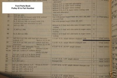

    I just compared the "AG" and the "7AB" pulleys and the "7AB" is larger and measures 5 7/16" diameter. This pulley has and engineering number C7AR-3D673-B and crosses to part number C7AZ-3A733-B. The Ford Parts book then identify it with a casting of "7AB". The smaller "AG" pulley was used on the C7OR-3A674-A PS pump commonly found on the 390 engine and as far as I can determine would probably work OK but would be incorrect technically for 67 GT-500's. Do we have consensus from the judges?

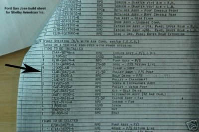

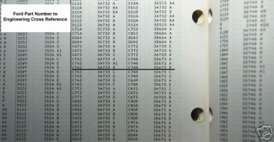

    I am not sure who gave you the 7AB pulley information but I agree with them. I posted a Shelby add and delete sheet that was used by Ford to document the changes from a regular Mustang to a Shelby unit on the Ford line. It is similar to a build sheet . It is found in many 67 Shelby's under the carpet. The engineering number specified in the Ford document crosses over to the Ford Master Parts Catalog part number . That part number cross over to the identification marking on the pulley as 7AB for a non A/C application. Now with that proof who has MORE credability? Your original owners possible faulty memory or Ford Factory documents and the observations of numerous 67 GT500 owners some of which are Shelby judges:rolleyes: That number is not just on one add+delete sheet but many. I agree that the price Bill Herendon is asking for the pulley seems like a lot but find another one? If you can't don't begrudge him for trying to get all he can out of his. It is a business for him and not charity. It sounds like just because you are finding it hard to find the correct pulley you want to justify your substitution of the other to the world :laf: . and then making some kind of sarcastic remark about Concours judges being once again wrong (which they can be) . I take that as a little insulting because I am a concours judge as well. Just so you know it is volunteer work. I would do a little more research next time before condemning the people just because they don't say what you want to hear. They may be wrong sometimes but how often are they right;)

    It is ironic that you complain about a dishonorable seller and then turn around and will change and twist statements to fit your purpose in a dishonorable way. You are as bad as the person you protest about but in a different way. The question you posed is what is supposed to be on the cars I posted Ford proof and YOU posted past owner here say. As far as the authenticity aspect is concern I did not address that in the post. WHO DO YOU THINK THE REGISTRAR EMAILED TO VERIFY THE PULLEY PICTURE COMPARISON YOU SENT HIM. You twisted the words again . This time Dave Mathews. He cc'd a copy of his reply to you, so I know what he said . I will not post the copy of his Email since it is not mine to post however I challenge you to post what Dave Mathews sent you :whistle: . In short he said he read the posts here (which I copied the address for him) and can see that I was not addressing the authenticity as you said but the application instead. As far as Billy Herndon is concerned I was making general statements that apply to all retail sellers. I do not condone misrepresentation of descriptions as my opinions on this very subject (and seller it seems) indicate many times as posted on the SAAC forum . As far as personal attack I will give it back the way it is given . If you don't like it don't invoke it.
