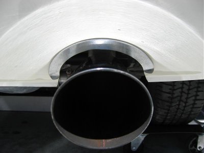

    These are the cast flat trim rings on my car #0031. Randy

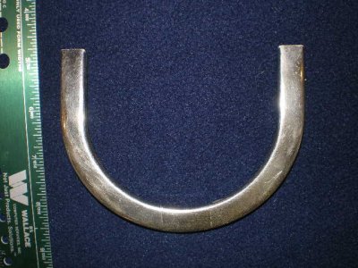

  15. wood27man
    wood27man Member
    Dec 2, 2007
    Re: 67 Exhaust Cut Out Trim
    I had a '67 GT500 and it had the cut-out valance. I had heard that you could simply cut the GT exhaust rings also, but on initial fitting, it was clear that the posts on the GT chrome rings did not come close to lining up with the holes in the valance and therefore were not correct. In digging some more in the parts boxes that came with the car, I found the trim, they are cast and I believe very specific to the early GT500s. Who knows what all Shelby did day-to-day on the assembly line, but the GT chrome rings were incorrect for my car.
  16. roddster
    Woodman, your car problaby has those "Cougar" cast ones which where also used. Stay tuned, we're trying to determine all the production differences in the 67 production year.

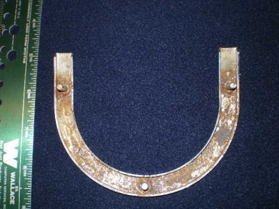

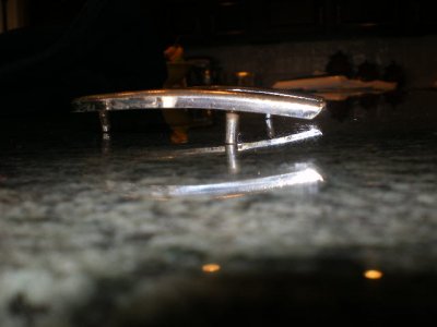

  17. wood27man
    wood27man Member
    Dec 2, 2007
    Randy, sorry for the slow reply, hopefully three pictures will come up of the cast trim ring from my '67 GT500 (#986). Note in the third picture, there is a slight "bow" to the trim piece, it is not flat. Jeff

  19. patty.dilabio
    327
    Nov 26, 2006
    Hi to all this thread.Great pictures of the correct cougar trim!! this is the type that belongs on any car built with a plain rear valence.And as we are finding as the production changes are being compiled...most of this changed by date,not by car number.There is an old how to article in the marque on how to cut and modify 65-66 aluminium trim to fit,and this is where they started appearing,the proof of this is the cars that are known original paint cars and the 65-66 trim will not line up with the original holes in the valence.An original valence will also have evidence of the cut edge with a very slight lined pattern from the snips used to do the job.The 3 holes were most likely done with a whitney punch..not a drill.This was quick and simple,but not as cheap as deleting it,which is what they did when the cutout style valence was used.I am still wishing for a digital camera from santa..:) :)
