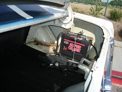

    Trunk mount battery (again, Registry confirmed): in 5S486??? I realize nothing was clear cut at SA, but that seems pretty far out of the typical trunk mount range. Anyone have any input?

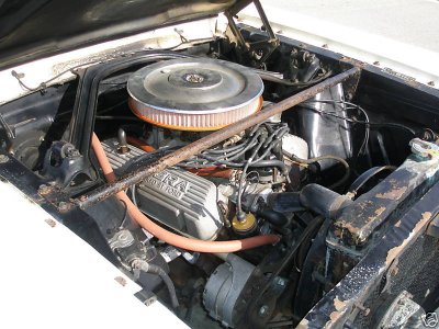

    What's up with that radiator? I don't recognize it. Was something like that ever on a car leaving SA?
    Any thoughts on why the front shocks would be blacked out? The engine compartment doesn't appear to have received a rattle can detailing job, it looks like it's seen 40+ years of occassional use.

    Looks legit - I see nothing in the pix that would indicate anything other than maintenance. He apparently has all the hard to find parts either on the car or in storage. The rear battery is just an anomaly, very cool "survivor" that would take very little to make a very decent driver. The tops of the shocks do look like someone tried to touch them up, and a few hoses would require replacement.

    He does mention the radiator in the listing:

    I love how rust can get under a tag.
    With more rust than the rest of the engine bay
    the monte carlo bar looks newly mounted

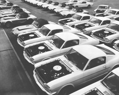

  8. tesgt350
    I have a B&W Photo saved in my Computer that is of the Parking Lot at the SA Factory that is full of Cobras and 1965 G.T. 350's. A couple of the G.T.350's have Lemanns Stripes already Painted on. I will try to find the Photo and post it.
  9. 66shelbynz
    66shelbynz Well-Known Member
    180
    Aug 25, 2005
    New Zealand (downunder)
    Here is the picture i think David is thinking of. No - not too many cars got
    factory Shelby stripes.....my '66 was one of them and the over spray looked
    just like in that photo.......i spose 'paint em up and get em out the door' was their moto.....

    I think the photo you are thinking of is the one without hoods with all the cobras. No stripes. [​IMG]
    This one has the LAX showing one car with stripes.
    This image shows stripe overspray somewhat!!
    Chuck Cantwell is with a car with stripes on the tarmac LAX

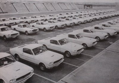

    My thoughts on this image tell me this is the arrival lot. Both the Cobra and the Mustangs are as they came to SA. Not on the mustang the K dress up kit on the engine, no cobra valve covers yet. Same with the missing hood, back seat, tach pod, welded export brace support, on and on. Even the battery is still in place.
    I am currently scanning all of Dave Friedman's Shelby archive photography, as soon as I get to the GT350 batch I will have more info. For now I am in the middle of the FORD GT program, Cobra's and the Daytona Coupe design and build.
  18. s2ms
    s2ms Well-Known Member
    282
    Apr 13, 2007
    PNW
    Correct, this is an arrival lot picture, before conversion into GT350s. But the export brace and welded support are on these cars and while it's not very apparent in that photo, the washer reinforced shock towers are also there. Those mods were installed at San Jose.
