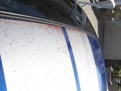

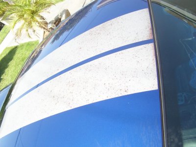

    Interesting thought re the "rail rust" idea causing the spotting on the silver stripes. It could be a possibility. I live in Southern California, about 7 miles from the beach and there are no rail roads anywhere near. However, my back yard opens up onto the Los Alamitos Armed Forces Reserve Training Center (AFRC). The AFRC is an active military training airport, with helicopters frequently overhead and F-18's, etc. landing & taking off on most weekends. Because I live down wind from the base, maybe something in the jet fuel is reacting with the stripes.
    Attached are a couple of photos of the "spotting." Note: the spotting starts out as a slightly grayish blemish and eventually turns a pretty bright red spot and interestingly enough is concentrated at on top of the roof nearest the windshield.

    From the Photos posted above, I would have to say the the Shelby Stripes, are what I call, "Two Piece" Stripes. The Top Part of the Stripes are flaking off where the Wind hits it. The only thing I can think of to do is to have New Stripes cut from Silver High Performance Vinyl. The problem with doing that is, the Silver is has smaller Metallics and it is a few shades off from the Silver Stripes from Shelby. I am told that the Silver on the Scoops is Painted on so you would also need to repaint the Scoop if you change the type of Vinyl used.
    OR, you can bite the Bullit and get the Paint Code for the Silver used on the Hood Scoop and have a Shop Paint the Stripes on.
