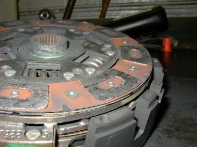

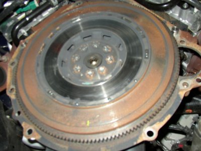

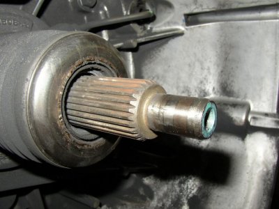

    I went to the dealer to take pictures of the failed clutch.
    The flywheel has wear into the cast iron face with the clutch face seeming to have less signs of wear.
    Input splines were dry without any lube.
    The dealer told me they can source the original parts out of Toronto. Does anyone know if these original parts are ordered that Ford automatically ships out the new 2010 design superceeding the initial part numbers?
    I sure do not want the same part going back into the vehicle.

    The 2010 clutch is a 10.5"organic material dual disc manufactured by Sachs out of Germany. The original 8.5" diameter needed to use the ceometallic lining that grabs and induces a great deal of wear to the flywheel.

    I contested FORD SVT ENGINEERS on the poor FLYWHEEL material selection.
    Unfortunately the problem will wear out any flywheel of castiron materials since the CERO-metalic linings on the clutch are so hard. There is NO WAY FORD should have selected this material for the street as you CANNOT enagage the clutch without eventually wearing out the softer flywheel.

    My existing Valeo clutch faces looked brand new just like the pictures on the TSB. This should be a RECALL for all 2007 - 2009 GT500's. It IS a safety issue if it slips while going to pass a car!
    After much deliberation and a formal letter I wrote to the dealer to present to Ford Motor Co. they FINALLY agreed to upgrade my car to the NEW replacement parts as per the 2010/2011 clutch design.
    TOTALLY DIFFERENT design manufactured by SACHS in Germany. This clutch and Flywheel part numbers appears on the first two lines on the TSB. These parts are an organic material, 10.5 inch diameter and are very good for street driving. The car drives totally different. Light pedal and no sound on engagment due to organic discs.
    The OEM initial clutch is an 8.5" diameter VALEO clutch design that is a smaller less intertia design that the FORD engineers tried to keep the cost down BUT they forgot that these cars are driven on the STREET. They also forgot that they are mostly purchased by the general public that are HIGHLY FORD ENTHUSIASTS.
