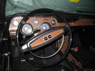

    Attached are some pictures of my uncle's '68 GT500. He was told by someone that the steering wheel was wrong for the car. My assumption is that they said that because it's not a deluxe wood grained wheel, however it's my understanding that not all '68's had the wood grain wheel. Any thoughts from the experts (Pete?... Tim?). I'm not sure if he thinks the shift knob is correct or not, but I'll let him know it's not.
    BTW - The car is a 22 year old restoration. Not correct, but not modified. He's had it for about 12 years.

    The person that told your uncle the wheel was incorrect. Build sheets confirm not all cars had woodgrain wheels. Two different part numbers are listed. Do you have a build sheet for this one? Do standard wheels have the chrome band on the inside? Not sure why, but that looks odd to me.
    I would say the shifter knob has been replaced at some time. The handle shown does not appear to have the reverse lock out disc either?

    Looking at the pic, a few things have been changed out. The wood grain cluster bezel, console gauges, drivers mirror, steering wheel wood grain,..[and the standard wheel doesn't have any chrome band on the inside].

    Pete's correct (like always) that some cars had standard black wheels. They would be early cars and like Pete said would be identified by the build sheet. The one you have appears to be a deluxe wheel that somone restored black. You are correct as far as the registry, some of it can be owner reported so get the Marti.

    I looked over the material last night and there were some cars built in the second week of March 1968. They had standard black steering wheels. The build sheets have a different code for the steering wheel. I suspect this was a supply shortage, because I have a build sheet for saddle interior car built at the same time and it has the woodgrain wheel.
    I am not sure when your uncle's car was built, but upon further review I would say it seems a bit early to fit the pattern. The build sheet would be your best friend here.
