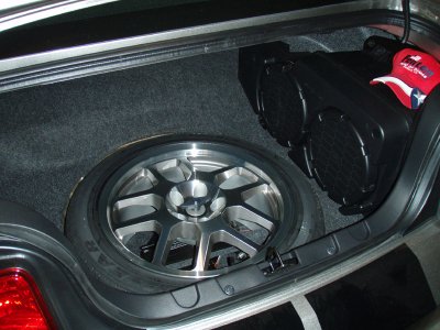

    I just removed the inflator pack from my GT500, and installed a GT jack, tire iron, and an SVT 18x9.5 wheel, and front P255/45ZR18 Goodyear F1 Supercar tire. It just squeezes into the well, but, of course, the well isn't deep enough for the wide tire, so it sticks up through the new hole in the trunk mat/fiber panel.
    According to the Goodyear data panels, the front and rear tires have almost the same diameter, so I think it will work OK for a temp spare for the rear, too (better than the 50mph standard temp spares).
    I haven't had many flats on the road, but pretty much every one of them has been of the not-fixable kind of tire damage. The slow leaks I can take care of at home at my leisure.

    No you do not have a spare tire. Yes the wheel will clear the brakes. The tire will only go down so far in that wheel well. You will need to find a low profile jack that will go under the car with a flat tire. I suggest an electric impact wrench.

    I like the idea, I'm going to choose a bi-directional tire though!
