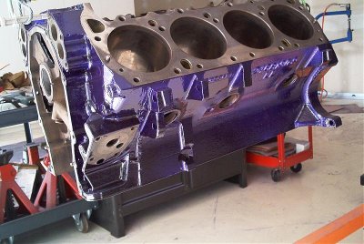

    Eric - Patty is correct about proper prep of your oil pan. The only exception being that no amount of suface cleaning will drive oil out of the pores. It will require pre-baking and degreasing for powdercoat which is why some powder shops will shy away from a job like this. We have a custom shop so we have seen it all. The good, bad, and totally greasy. We've even done Candy Purple Engine Blocks for a Gentleman in Florida. (1966 383 Chysler Engine Image Included)
    Thorough surface cleaning with akali detergents such as "Dawn" and/or solvent cleaning is generally all that is necessary for the Glyptol Treatment. -Geary
