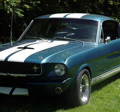

    On my 65 "clone" in order to do a semi authentic scheme with it I reversed the colors. Guardsman Blue car with Wembledon (sp) White stripes. Like the Mark Donohue 65 "R" model. I had some 3M vinyl "GT 350"'s made that are a dead ringer for the white color used on 65's and the correct size. after painting on the stripes the car was clearcoated ... and it looks great.
    I still have a couple of them (GT 350's) left. If anyone wants to do this .. E-mail me.
    I think the 65 rocker treatment looks much better than the 66.. Pete Brock was right!
