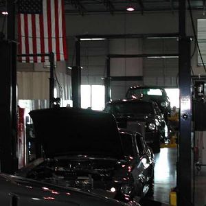

    Interesting that it has the chrome appointments
    Friend has a black on black X code Cal Spec sitting in a hanger
