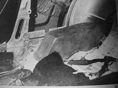

    please help, does any one have any pictures on how to install the 1965 OVER RIDE traction bars on a 65 shelby? I'm looking for the pictures on the bars that go through the rear floor board.
    I have looked everywhere and can't find any
    Help, help, help!!!
    thank you
  2. 67GT500#2100
    55
    Here is a picture of the originals being welded in. Probably won't help too much.

    Here are two shots from sports car graphic 6/65.
    If you ask specific questions you can get good info..
    good luck,
    jimbo
  4. stallions
    stallions Member
    Jan 17, 2007
    michigan
    thanks a million, that is what i was looking for:thumbsup:
