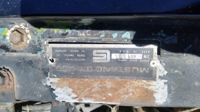

    Has anyone heard of this car? I was at the Reno NV swap meet 4 weeks ago and a worn out black and gold GT350H caught my eye in the for sale area. Sign said CLONE and it had a shelby tag with 6s1834. The 3 was miss stamped and looked fake. Just curious what the story is. 20160804_110831.jpg

    The tag has been removed and replaced with incorrect rivet. According to the SAAC Shelby Registry, 6S1834 resides in Germany. It may now be back in the U.S. A check with the 1966 GT350 Registrar might shed some light.
  6. rshelby
    The VIN tag also says "Shelby America, Inc." not "Shelby American, Inc.", missing the "n", so incorrect tag / plate as well.

    There was a beater 66GT350 at the MCA show in Reno earlier this year. Looks like it might be the same. Had a large for sale sign on it and a mention that it was a tribute, copy, fake .......Never looked under the hood as I guessed that no one would use a Shelby tag and another cars VIN on it these days. Especially since they already fessed up about it not being a real one

    Didn't look too close at it, thinking it wasnt worth the time. Looked real ratty. I took a pic of the tag because it had some 'patina' and maybe held a story. I obviously didn't look hard enough to catch those details.
    Good eyes spotting the mis spelling and rivets. didn't even catch that....duh!!
    Is the car a rebody or did they just pin the poor repop tag and use the serial# from the one in germany? Anyway, he was asking a healthy chunk.
