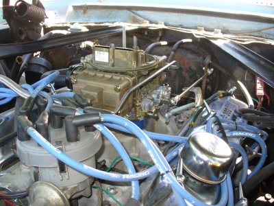

I tried to search, but didn't find my answer-I recently acquired a 4118 Holley, that came with the Lemans fuel bowls. However, the previous owner didn't use the correct fuel line. The steel line is the easy part. I would like to find out if there is a common brass solution? Thanks!
To answer this question, if anybody else doesn't know, it was a 1/4 inch into 1/8 compression fitting. Unless I have problems getting the brass to seat, it should be an inexpensive, permanent solution.
FYI 4118 came with center hung bowls and did not come with Lemans bowls from Holley. The 3259 list S2MS 9510 A carb came with lemans bowls which is what you may be thinking of . The 4118 is a service replacement carb for a 68 GT350 . The 4118 never came on a Shelby from the factory. Someone may have switched bowls to make a look a like carburetor .
Thanks for the carb ID info. I will leave the Le Mans bowls on the carb, and keep it as a 'clone'....I have a few complete carbs with those bowls already, I guess I just like the looks!
