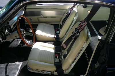

    I was wondering if someone could give me an idea of what vehicle the white was from so I can paint my interior trim pannels. This one is definately white, not parchment.

    Strange, because white was not offered. Sounds like you have some custom work. In 66, 67, and 68 white was not offered in the Mustang, so of course not in the Shelby, either.

    If your just wanting to make all of your Interior trim panels to match? Pull an accessible piece that you think is in the best condition to you? Take the panel to any major, Automotive Paint Dealer that has a Color scope, They'll mix you up a Pint or Quart, what ever you think you need.

    That photo isn't his car.

    The last registry I purchased was the 1997 issue. There is no mention there, however based on the parchment purchases, they are two different animals. It appears that the upholstery was possibly parchment, but the plasti-glass portions of the trim and dash are some sort of white. It doesn't appear to be the same as the 65-6 interior white, because it doesn't look to have the slight yellow tones in the white.

    Many times referred to as parchment . You will have to have the interior paint mixed for the best match to the door panels and upholstery. The Shelby modified bumper brackets were painted a semigloss black. I hope this helps.
