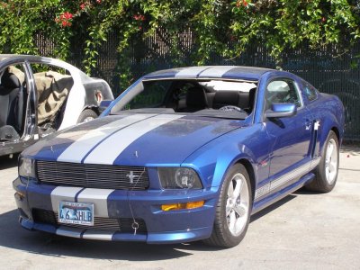

    Hi Caligirl:
    This has been an ongoing discussion thread. Just scroll down in this forum and you will find several threads about stripe problems, mostly with the Shelby GT's (SGT's) but some with the GT500's, too. The thread, "07 Shelby GT Stripes" has 36 replies (some of mine among them). I also have an 08 Shelby GT (08SGT1050), Vista Blue with Silver stripes. Mine have been replaced once, as has the hood scoop. I still love the car and if the stripes go south agian (rust colored spots), I'll bite the bullet and have them painted and clear coated to end the problem forever.
    Another thread is, "This is Ridiculous! My stripe & scoop update" has 9 replies.
    Good luck and enjoy your SGT.
    Bob
    4.6 SHLB

    Hi All:
    Yes, I had issues with the horizontal silver stripes on my SGT. I had the original stripes replaced and subsequently had 2 more sets of the stripes replaced. All were done under warranty. Pacific Ford in Long Beach, California, where I bought my SGT in April 2008, took care of those problems. However, each time I had to have the stripes replaced, and it looked as if it was going to be an ongoing and repetitive problem, I lost the use of my SGT for many weeks. Both to get the stripes sent to them by Shelby and then to get on the schedule of the very busy stripe installer. Finally, in August 2010, I had Pacific Ford paint all my horizontal stripes on. The cost was a little over $4,000. Pricy, but in my opinion, worth every penny. I've had no issues since then, the stripes look as good today, as when I picked up the car in early September 2010. My SGT has a little over 40,000 miles on it now and I had purchased the extended warranty. I don'[t know if Shelby or Ford would have stood by the extended warranty to replace more of the bad stripes. I'm just glad that one very vexing issue with my SGT is far behind me and I can go on driving and enjoying my 4.6 SHLB.
    Bob
    4.6 SHLB
